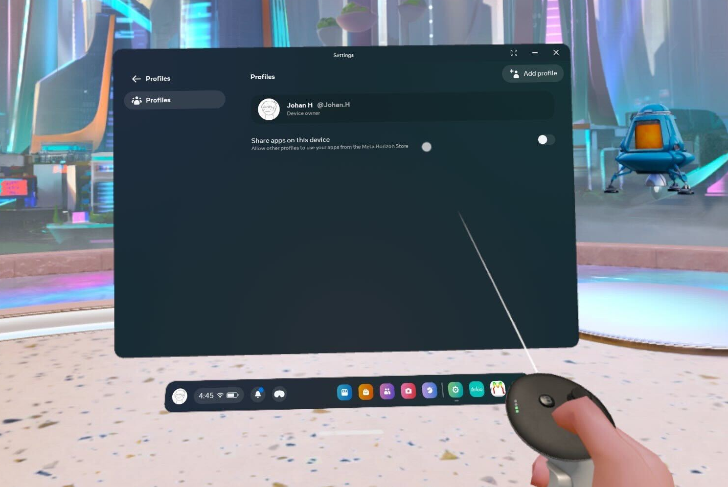

Running the same app on multiple Quest headsets using the same Meta account can result in an issue where the headsets will show a warning, “Already playing this game on a different headset” or "multiple devices can’t access this app at the same time"
This is a known issue with Meta Store apps that use the "App sharing" feature. When "App sharing" is enabled on any of your logged-in devices, it prevents your apps from running simultaneously on other headsets logged in to the same account. You can work around this by disabling "App Sharing" from all your devices in Settings>Profiles
Disabling the app-sharing feature or removing guest meta accounts from your headset allows Quest Store apps to run simultaneously on as many devices logged in to the same Meta account as you like.
