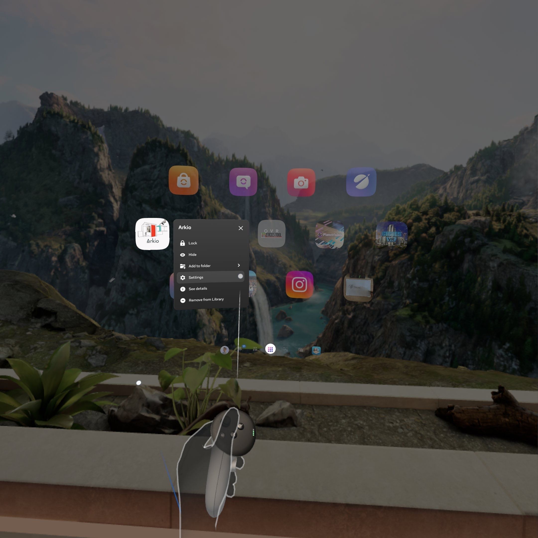

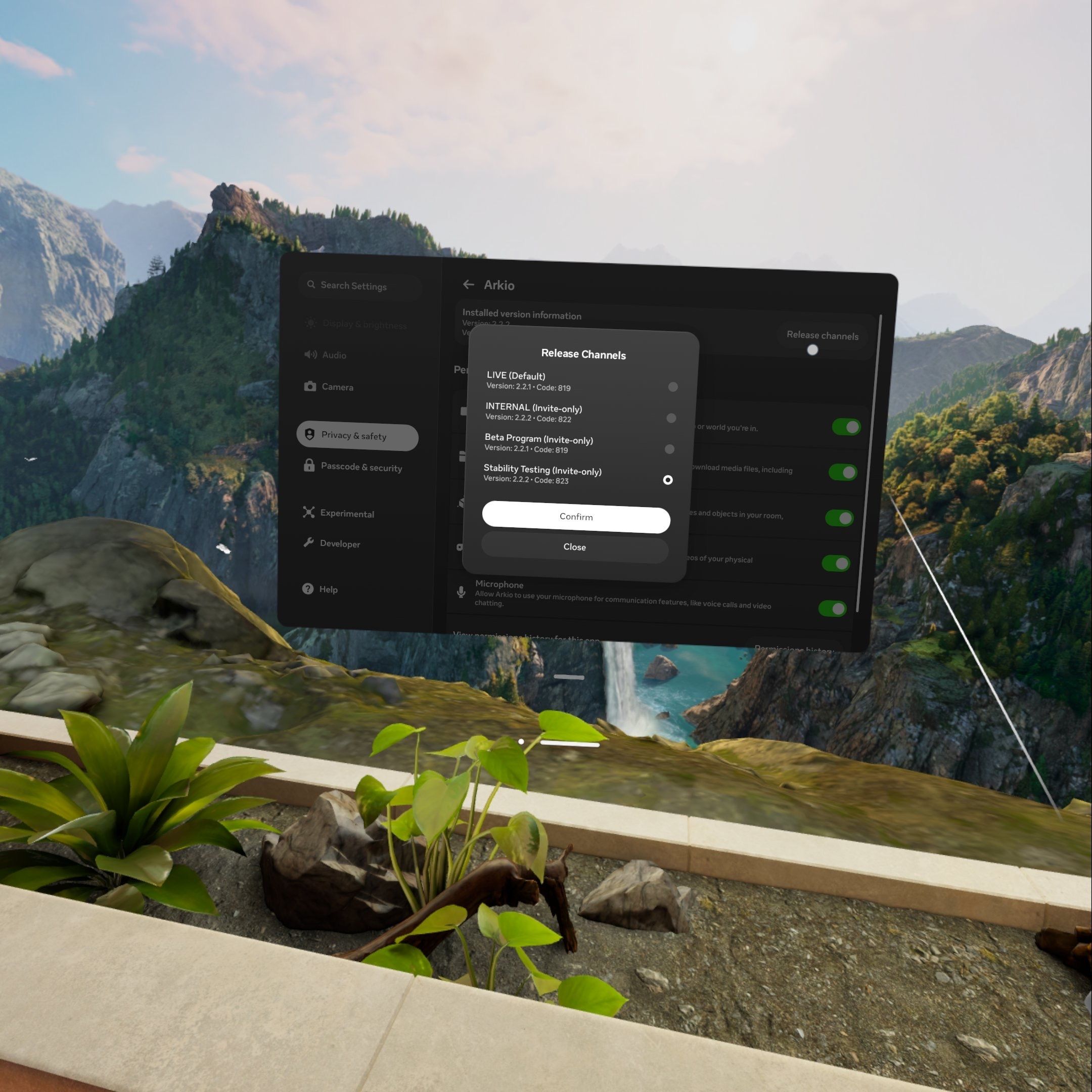

After joining the release channel with your Meta account, you can switch between the current release version of Arkio and other release channels by going to your Settings > Privacy & Safety > App permissions (clicking and holding the trigger on the Arkio app icon will show a settings dropdown that will directly take you there)
Then, select a different release channel at the top. After switching versions, the Arkio app will be automatically updated the next time you start it.
