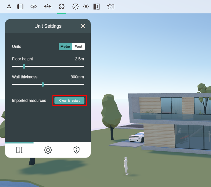

Temporary resource files
If you experience problems with your imported/downloaded content, such as files behaving oddly or not loading or showing in your imported files list. You can best unlink your Arkio Cloud and clear your temporary resource files using the “Clear & restart” button in your settings. This will reprocess all source files in your Import folders and redownload any models and images that have been shared with you when you open the scenes again.
