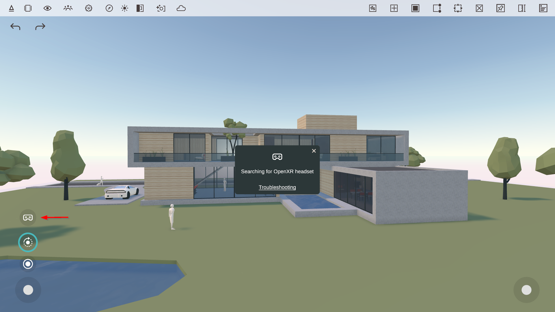

For PC VR, we recommend using Arkio’s Windows installer, which includes our plugins. Arkio starts in non-VR mode. Pressing the VR icon on the bottom left searches for your active VR headset in your system using OpenXR to launch the correct runtime for your headset

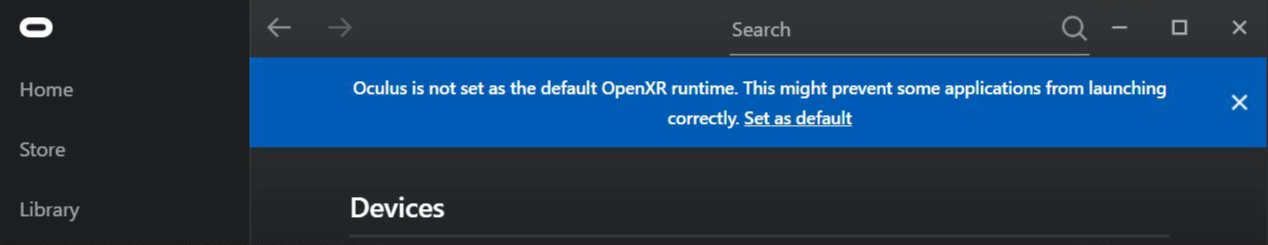

If your OpenXR default settings are not configured correctly, a notification should appear in the Meta Quest Link or the SteamVR app to help you set them up correctly. You can set this in Meta Quest Link > Settings > General
