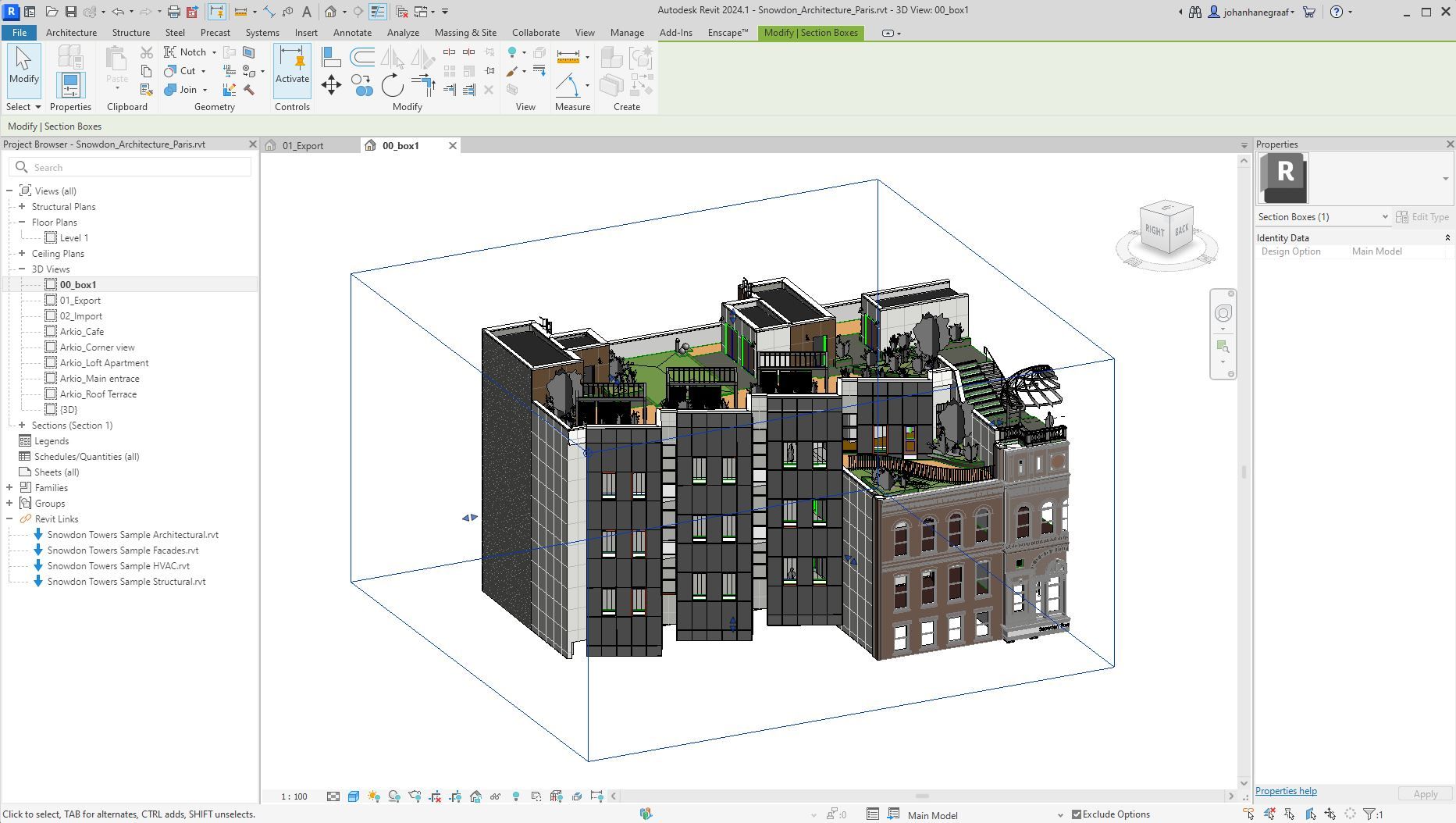

In Revit, use a section box in your 3D view to limit the area being exported. For large projects, prepare separate views for a building, wing, floor, atrium, or courtyard instead of exporting the entire site at once.
If an export fails, test a smaller section first. Gradually expand it to identify which area or object causes the problem.

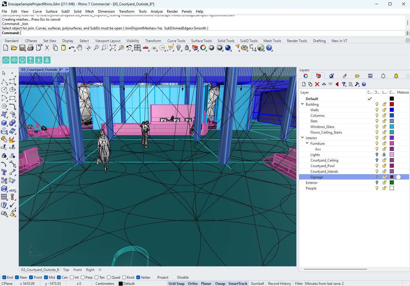

  • Rhino: Layers and object visibility.

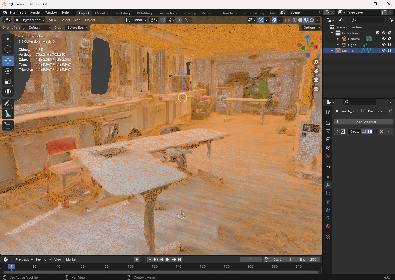

Dense meshes may need additional preparation in a mesh editor such as Blender or 3ds Max, even when they are part of a project exported with an Arkio plugin. This is particularly useful for LiDAR and other 3D scans.
Use triangle statistics and a wireframe view to find dense areas. Around 500,000 triangles is a useful starting target for an individual imported model, not a fixed import limit or a guarantee of full detail. Suitable complexity depends on your device, the rest of the scene, textures, and how closely the model will be viewed.

  2. Join related mesh objects where appropriate. Combining surfaces that belong together can help Arkio simplify them consistently. Keep objects separate when you need to move or manage them independently. Joining objects does not automatically weld their vertices.

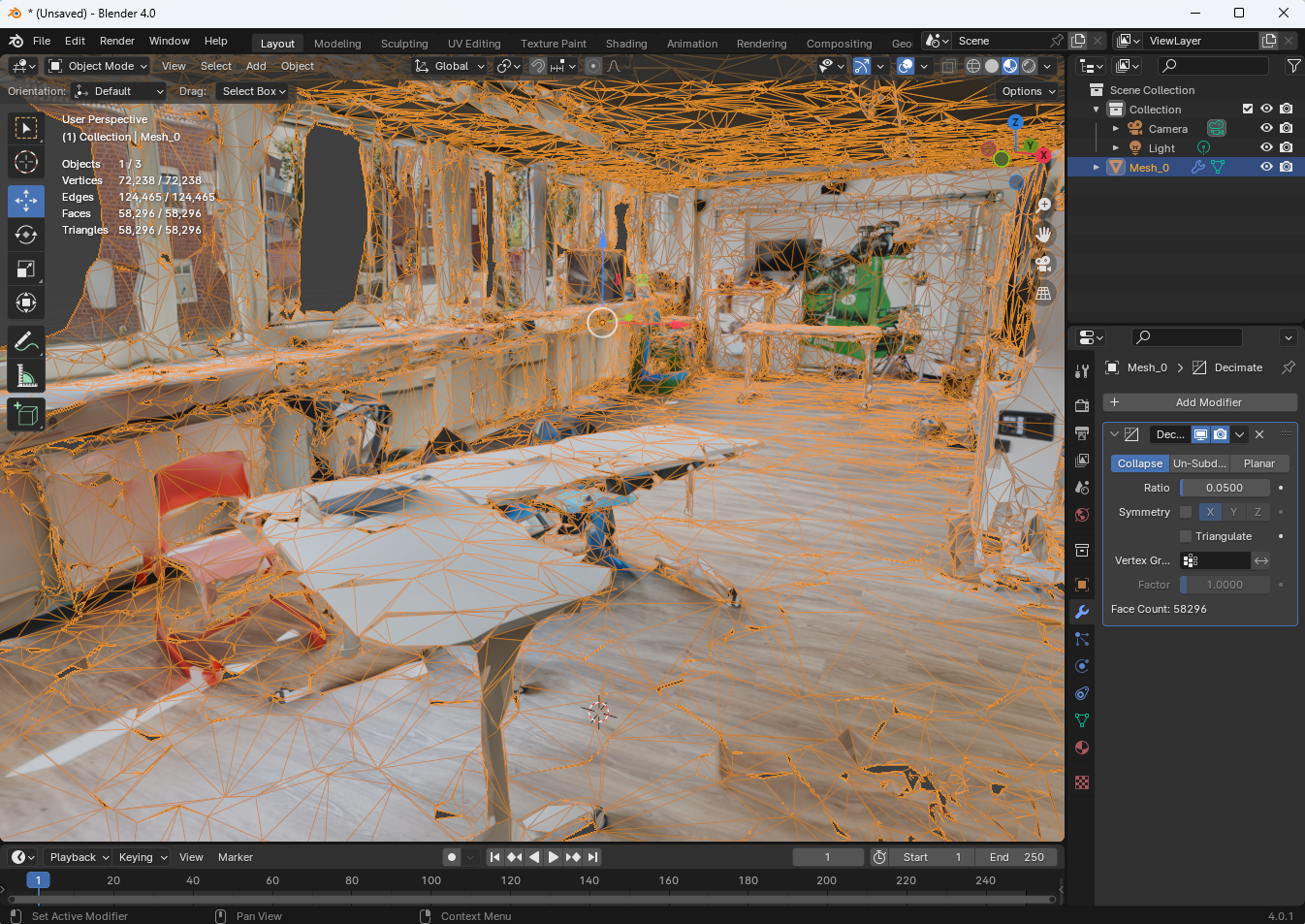

  3. Weld vertices that should connect. Some scans contain disconnected triangles along surfaces that should be continuous. These fragments can disappear as model detail is reduced. Use a small merge distance and inspect the result so you do not collapse nearby details or join separate surfaces.
  4. Reduce the triangle count. In Blender, add a Decimate modifier and lower its ratio gradually. Check the silhouette, openings, thin elements, and textured surfaces as you simplify. See the Blender Decimate documentation for its controls.
  5. Export an optimized copy. Apply the intended modifiers or ensure they are included in the export, then export as GLB. Check that the exported file retains its materials, textures, scale, and orientation.
  6. Test it in Arkio. Inspect the model up close and from farther away on the devices you plan to use. If important parts disappear or performance is still slow, adjust the mesh and export again.

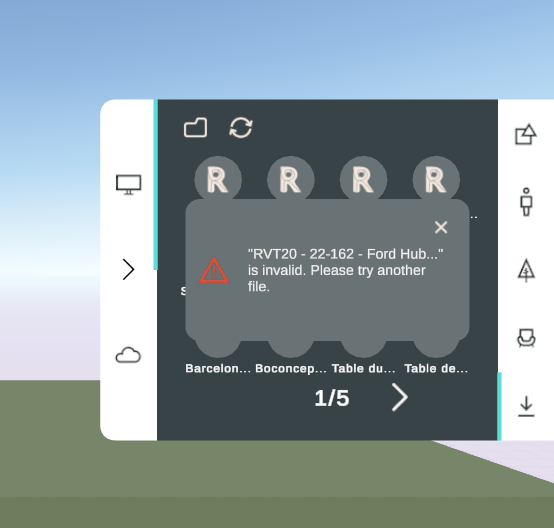

Troubleshoot a model that does not load
  1. Check the exported file. Open it in a compatible desktop viewer or mesh editor. If it also fails there, inspect the source model and export settings before importing it again.
  2. Check supporting files. For glTF or OBJ exports, include the required companion files and textures and preserve their folder structure. A missing dependency may cause incomplete geometry or materials.
  3. Try a smaller export. Hide most objects or narrow the section box. Add parts back gradually until you find the object or area causing the failure.
  4. Review local import files. If a failed import keeps being processed, follow Access and manage user files to locate the relevant files and temporary resources. Keep your original models and saved scenes before clearing anything.
  5. Contact support if the problem persists. Email support@arkio.is with your Arkio version, device, source application, file format and size, and the error message or a screenshot. A small example file that reproduces the issue can help us investigate.
