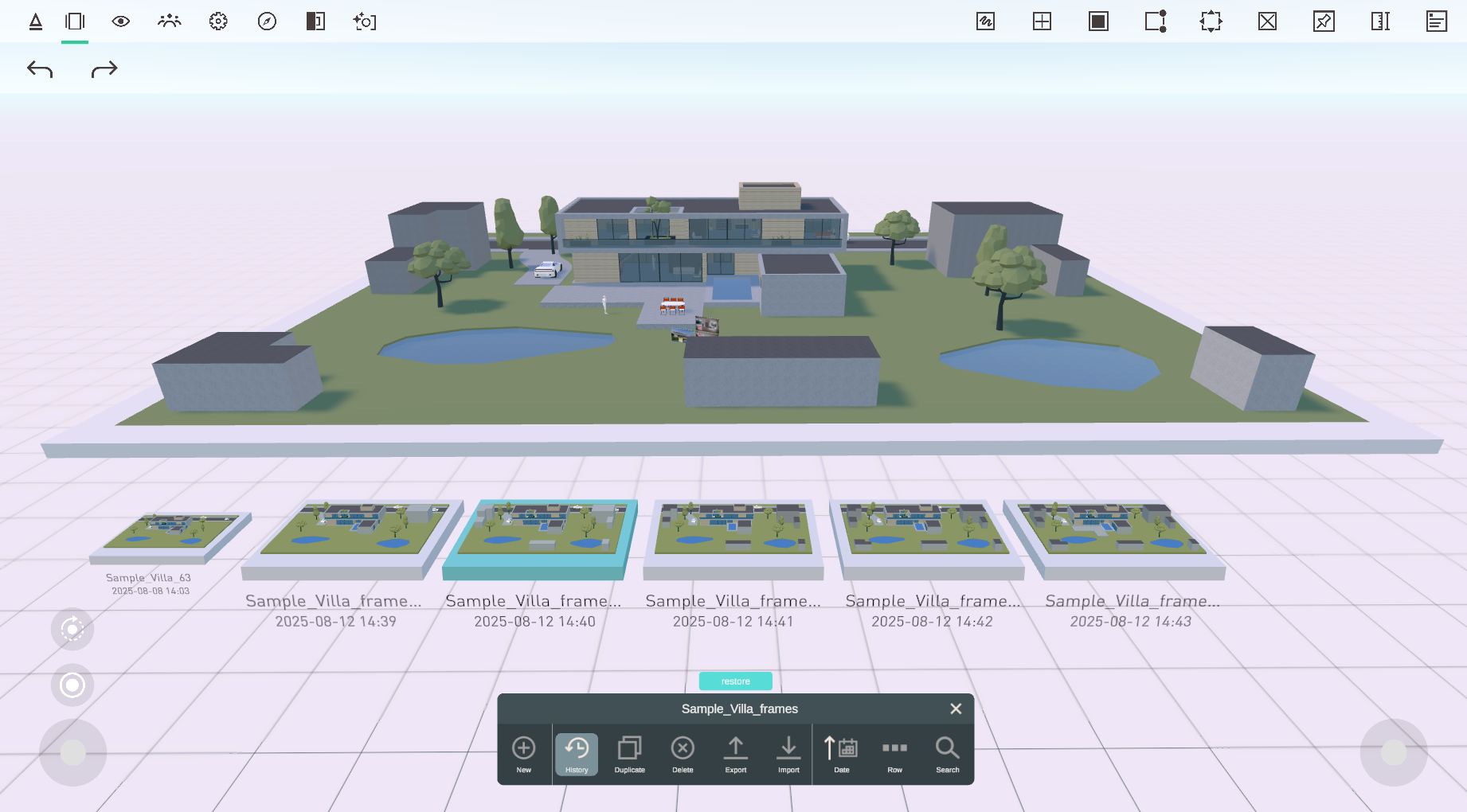

When you have broken geometry in your Arkio scene, or you see a red platform under your saved scene plate. You can use Arkio's history mode to find a recent backup on your device. (see File management) Backups of scenes are created every minute and stored in Documents\Arkio\UserModelsHistory, so a healthy version of your scene should always be available.
The steps to restore your scene are
Click the history mode and navigate to the model/time that looks correct
Click restore to bring back the selected platform to your main Arkio scenes
Inspect the restored scene to see if it contains all the latest geometry
Repeat the steps to find and restore the most suitable scene
