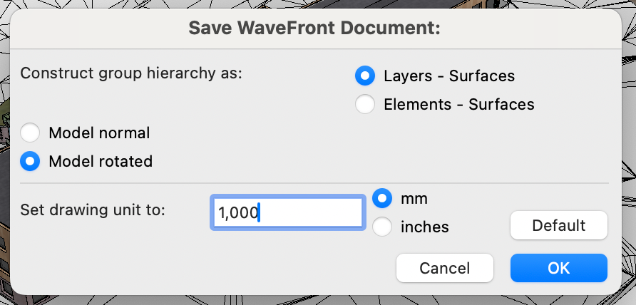

Arkio can import models in inches, feet, mm, cm, and meters from the import panel. If your modeling tool supports exporting to OBJ and GLB, you can often select the export units. We recommend exporting your creations in meters, the default units used by most 3D tools. If your model is exported at other scales, you can manually scale your imported files after placement by applying proportional scale increments. By editing the corners at other scales, you can also manually scale your imported files after placement using scale increments.
3D programs can use different orientation coordinates. It is easiest to correct your orientation from the source modeling tools. Arkio uses a left-handed Y-axis-up coordinate system, similar to Unity. If you are using Blender or other modeling tools, you can set the coordinate system at export time to ensure your models are exported in this orientation.

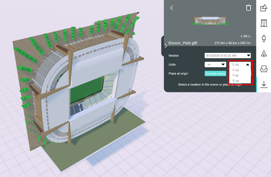

If models still load in the wrong orientation in Arkio, you can choose a different up-axis from the import panel dropdown. You can also place the prop on the sides of other Arkio geometry to orient it to any custom angle.

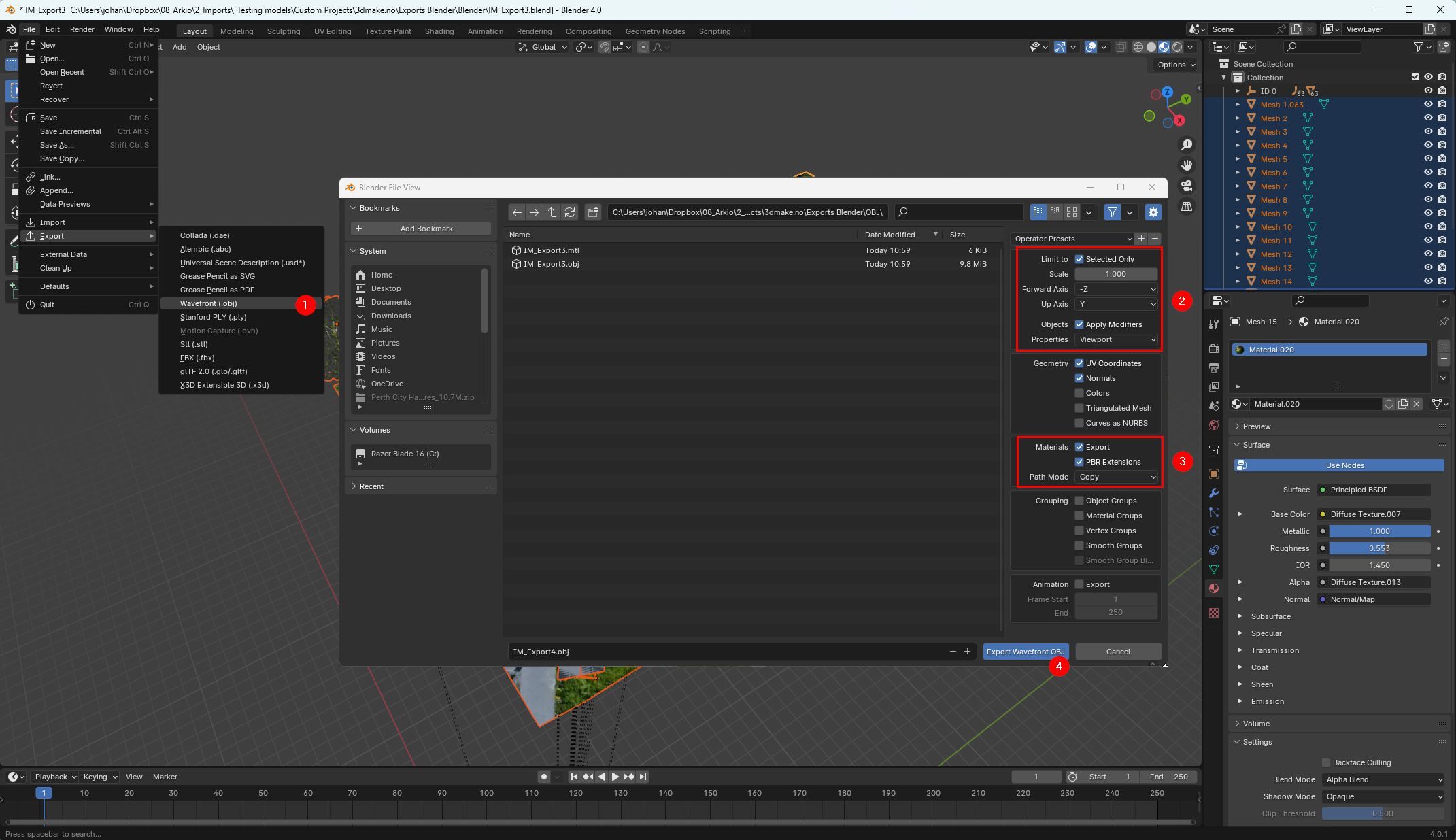

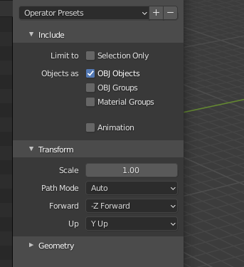

We recommend exporting your geometry in the modern GLB format, which includes materials and textures and is less prone to loading errors. You can use the following blender settings to load OBJ files directly into Arkio.
More information is available online about modeling software, including textures with their relative paths to the OBJ files. In Blender, you can use the materials Path Mode 'Copy' option to copy all needed textures in a subdirectory next to the exported .obj file.

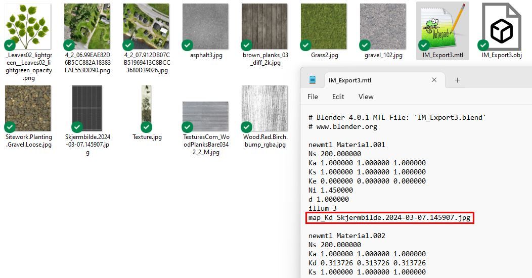

Once exported, you can open the MTL file in Notepad to check if the texture paths are pointing to the correct textures. The map_Kd parameter should point to a relative path (eg, folder\texture.jpg) and not an absolute path that can only be accessed on your system (eg, C:\Program Files (x86)\Common Files\Autodesk)

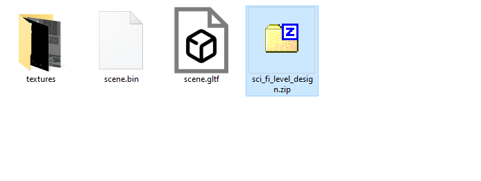

After testing the textures load correctly in the Windows 3D viewer, and before you custom-export files to Arkio, you can best zip the OBJ and GLB/GLTF files to keep all the materials and other files together for easy uploads and sharing. A GLB file can contain all the geometry and textures inside, but can also have some external texture files. glTF files can include a textures folder and a BIN file, which must be present for the model geometry and textures to load correctly.
The easiest way to load custom 3D files is to use Arkio Cloud to upload all files that belong together as a folder or a zip file.
