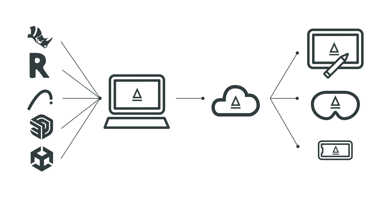

Archicad, Revit, Rhino, SketchUp, and Navisworks models must be exported using our plugins included in our Windows installer. After exporting from our plugins, Arkio will be opened on your PC to process your imports and synchronize them with other devices in your device group.
Synchronize imports between your devices
When linked to the same device group, newly imported files will be synchronized across all your connected devices. With your desktop devices having the plugins and more processing power, they can best process large Archicad, Revit, Rhino, SketchUp, and Navisworks files. The files are then optimized as Arkio resources and will be shared with other cloud-connected devices, in live Arkio meetings or by sharing a scene URL
Once a new file is imported (e.g., a large Archicad model is imported on your Cloud-connected Mac), your processed import will be synchronized with your other devices in the same device group (e.g., your iPad and Quest headset).

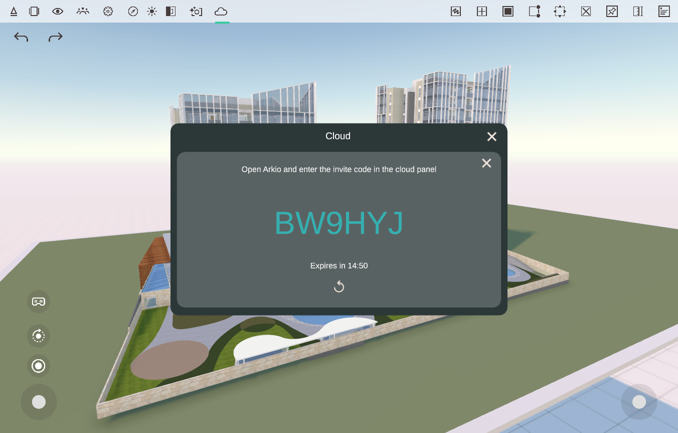

When new files are imported or exported from an unconnected device, Arkio will create a new cloud device group for you and show a temporary link code that can be renewed and used to connect other devices and the cloud portal at cloud.arkio.is to sync and manage these files.
The cloud settings panel in Arkio can be accessed from the top ribbon in non-VR and at the bottom of your main menu in VR. When you connect the cloud web portal to a device, you can manage all files that will be synchronized between your connected devices from this page.
If you join the same group on multiple devices, newly uploaded or imported files will be automatically synchronized with those devices the next time you run Arkio. Once your files are synchronized, they will remain available offline on your device. (see file security for more info)

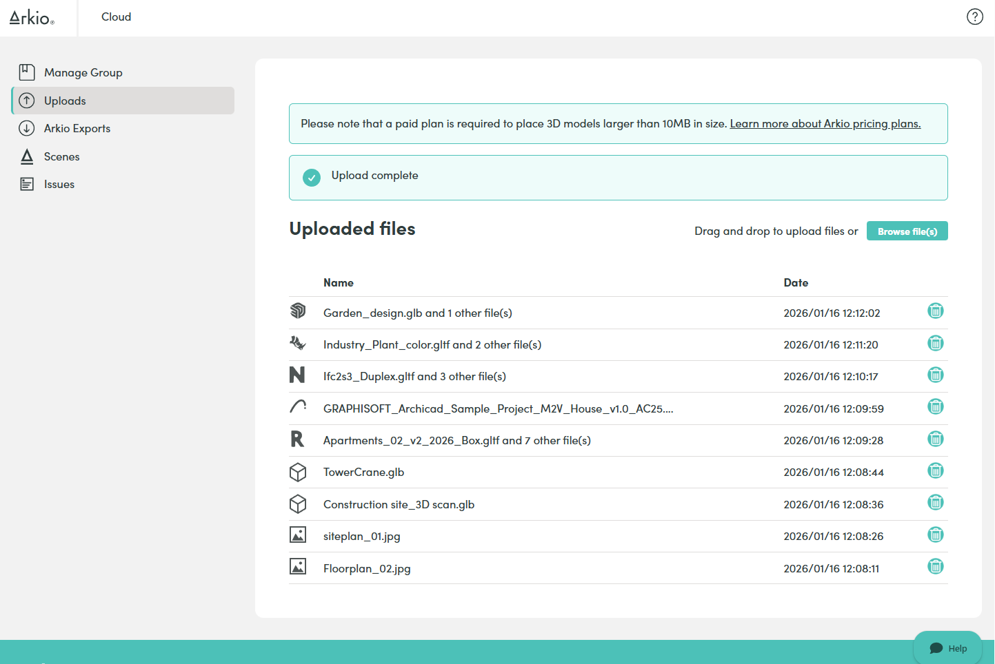

The Arkio cloud portal also supports manual uploads of JPG, PNG, OBJ, GLB, and ZIP files containing your models. You can drag and drop these files in the uploads page

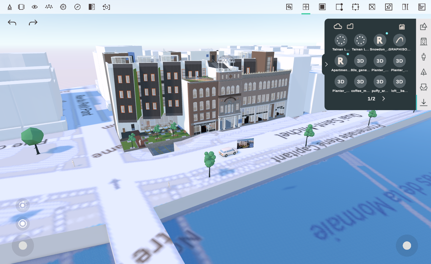

Once your files are uploaded to the Arkio Cloud and your Arkio devices are in the same cloud group, the files will be downloaded on your local device, making them available offline in Arkio. The assets will appear in your import drawer and can be placed in the scene.
Uploading files larger than 500 MB to the Arkio cloud portal may fail and display a warning. If you need to work with large files, it is best to first import the model to Arkio on a cloud-connected, powerful PC or Mac so it can be processed and synchronized with your less powerful devices.

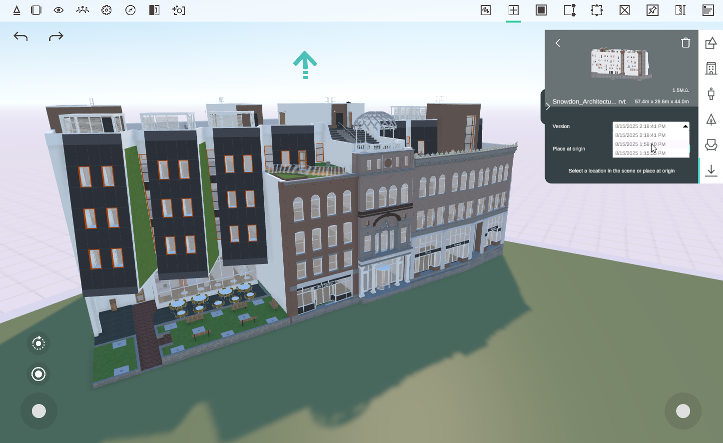

When you upload a new version of your model or image to the cloud by overwriting a file with the same name, Arkio will display a green arrow above the model to indicate that a new version is available. You can click this arrow to replace the older model in this scene with the new version.
Arkio will retain older versions of your imports, allowing you to revert to a previous version by selecting the desired date in your Create > Import > Placement menu and clicking "Update".

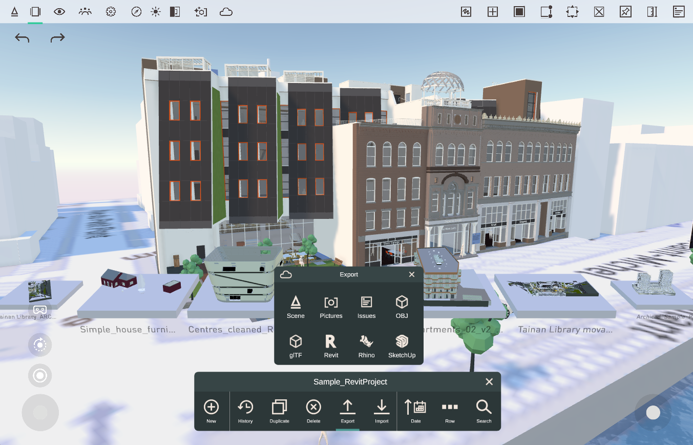

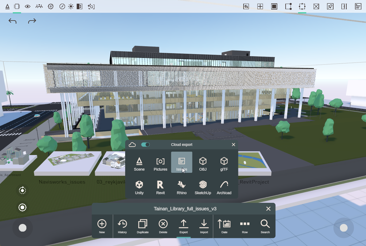

Arkio models are exported by selecting the desired export format in the file browser. When Arkio is linked to a cloud group, you can also export your scenes, photos and issues to the linked cloud group from the export panel. Export of your other files will happen locally on your device and will be automatically shared to your connected cloud group.
Files exported from Arkio via the cloud can be found in the cloud portal under 'Arkio Exports'. Exports to Revit, Rhino and Sketchup will be auto-downloaded by Arkio on your cloud-connected PC, to be converted back to native geometry of those modeling tools using Arkio’s Windows plugins.

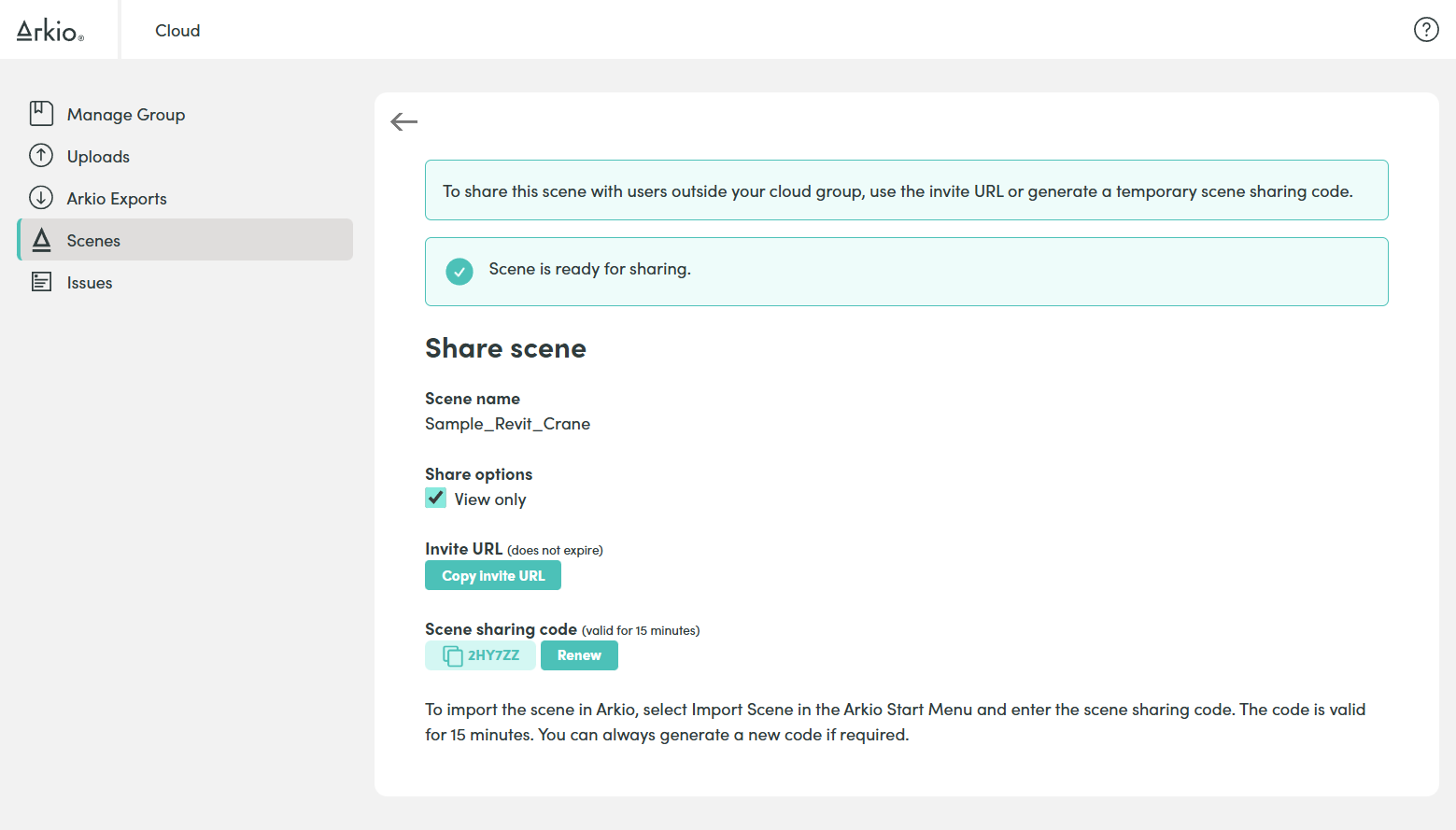

Scenes and all the imported content can also be shared using the Arkio Cloud. You can upload your Arkio Scene from the Export panel in the File Manager. After exporting your scene, it becomes available in your Cloud Scene tab and is shared with all cloud-connected devices. It can also be shared with others without requiring a live Arkio meeting.

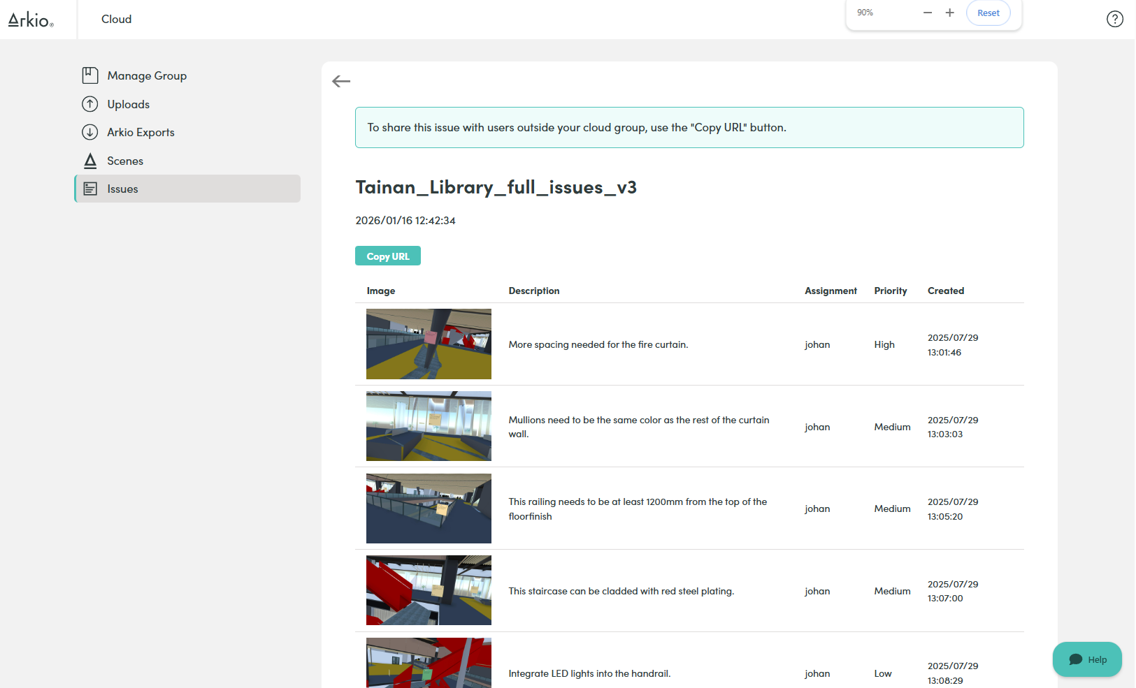

Notes exported to the Arkio Cloud can also be viewed in the cloud portal and shared with anyone via a URL that includes a screenshot of the issue, the note text, and its priority. You can learn more about notes and see an example of issue export pages on this page

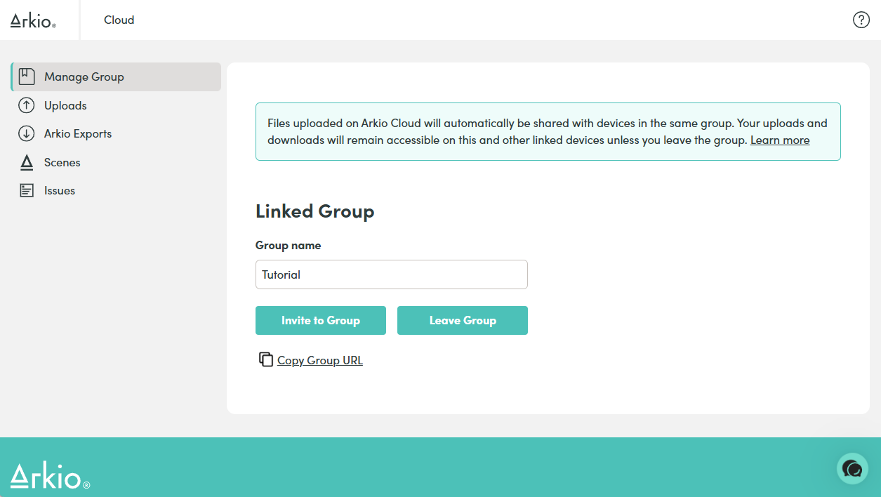

Managing your cloud groups
If you are still linked to an Arkio cloud group on one of your devices, but have somehow lost access to your web portal. You can generate a new invitation code in the Arkio cloud panel using the "add device" button.

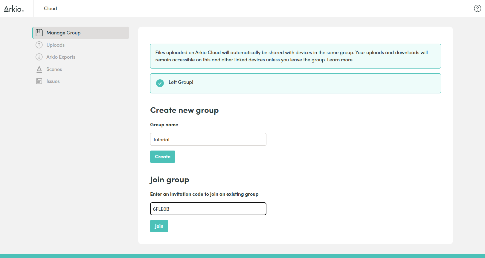

This will generate a new temporary code that can be used on other devices or the Arkio cloud webpage to regain access to your uploaded and exported files from your current Arkio cloud group.

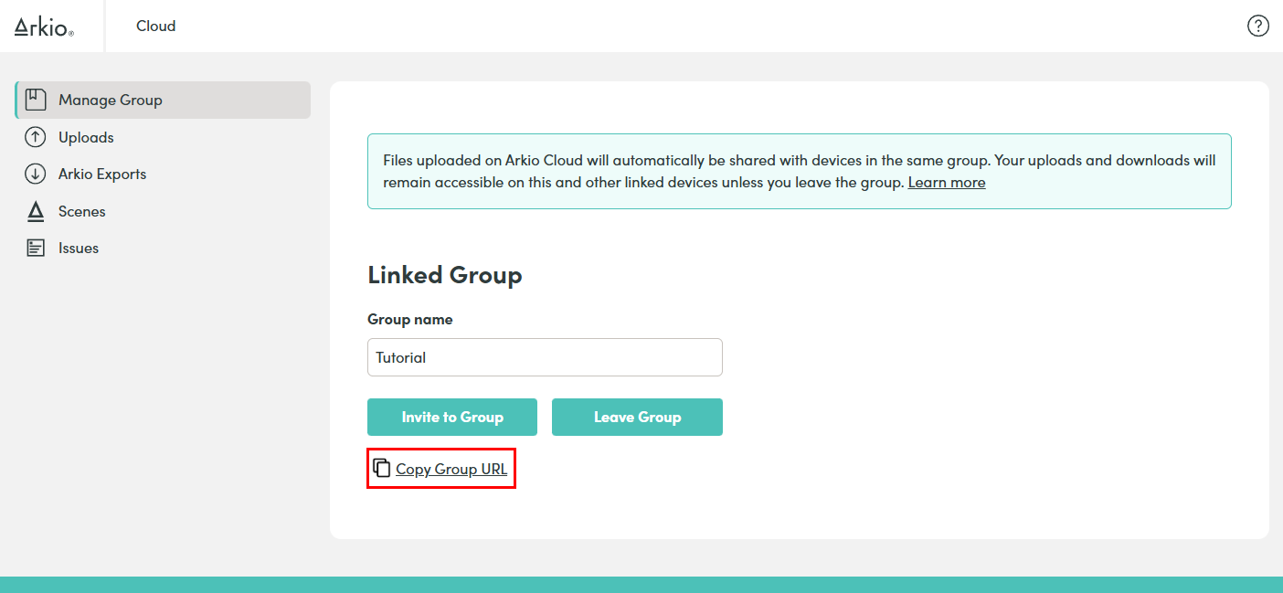

The Arkio cloud page saves your previous login in your browser, so when you return to cloud.arkio.is it opens your previous group. If you wish to bookmark this cloud group for future use or share all your cloud content with others, you can also save the long URL that directly logs you in to this Arkio cloud group using "Copy Group URL."
This will copy the URL to your clipboard so you can bookmark a permanent link to your Arkio cloud group or share access to all your Arkio cloud files with others in your organization.
