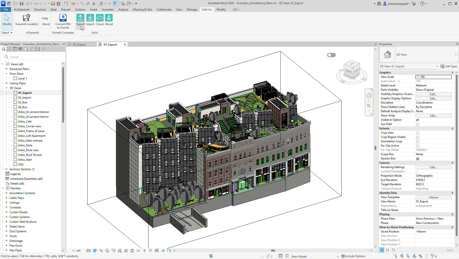

Step 1 - Use the Arkio plugins
Use our Windows plugin for Archicad, Rhino, Revit, SketchUp or Navisworks to export your model to Arkio. The plugins are included when you install Arkio for Windows. After installation, you can open a 3D view of your project in Revit or another tool, with the 3D elements you want to load visible, then hit Arkio > Export.

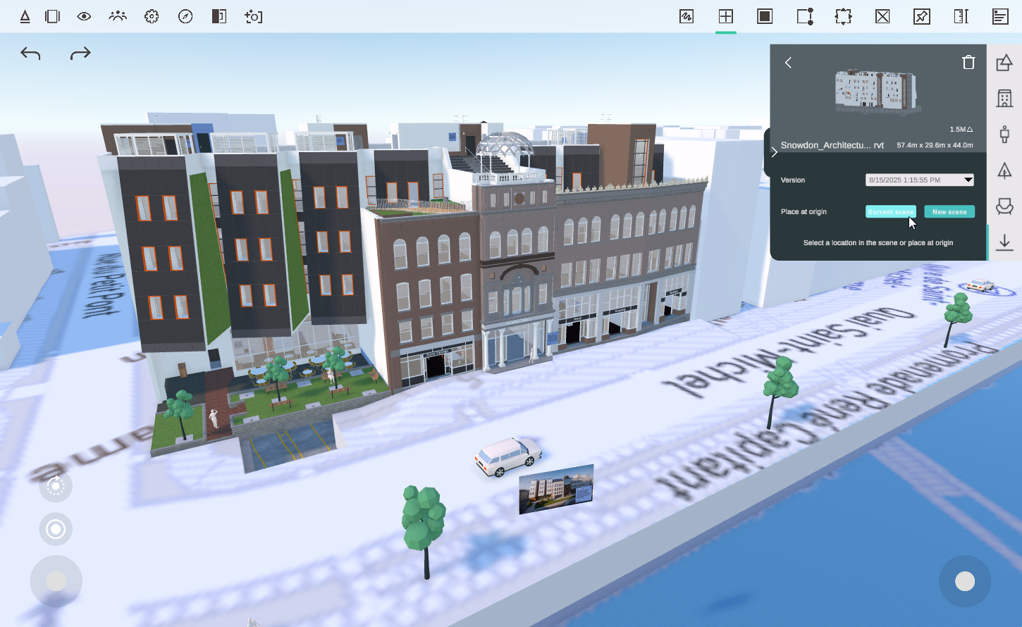

Step 2 - Place the model
Arkio for Windows will open the import panel after the plugin export completes. This import can be placed with the green buttons in the current scene or a new scene. (Clicking anywhere in the scene with the import panel open will place it manually)

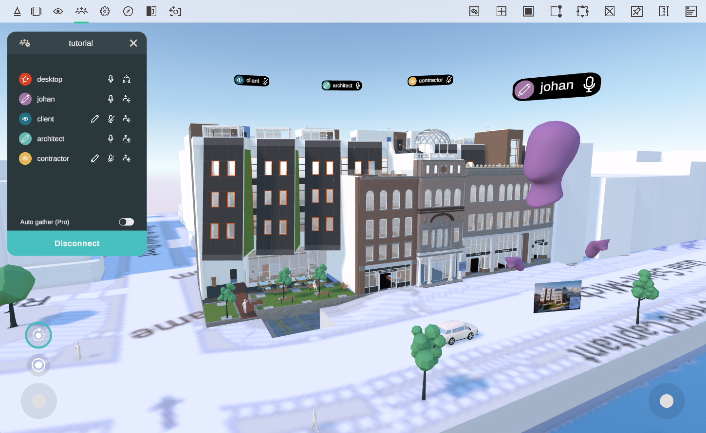

Navigate
Explore your loaded models by walking around or teleporting inside using your VR and non-VR devices.
