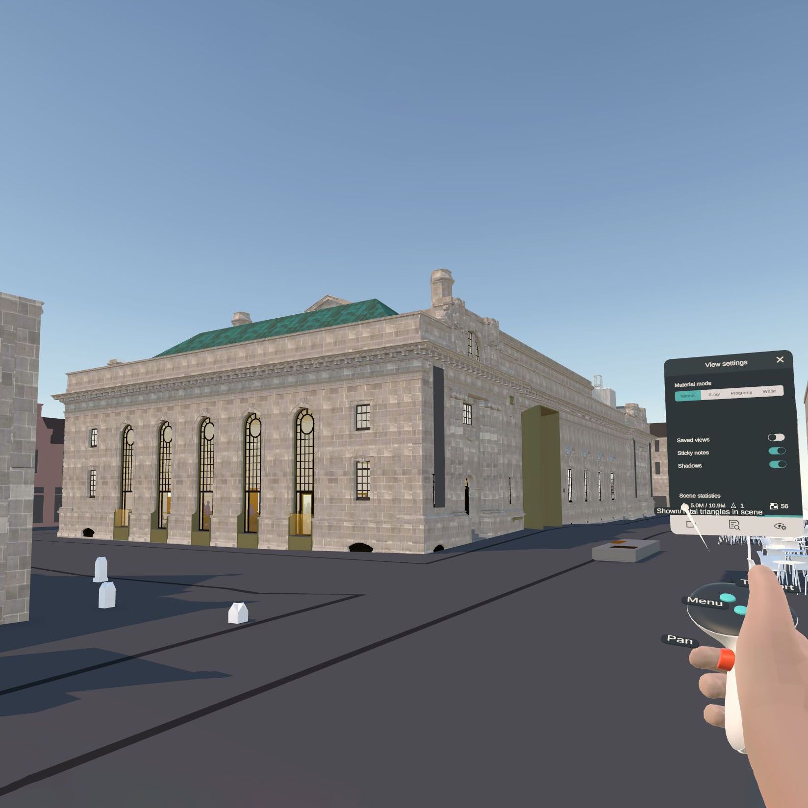

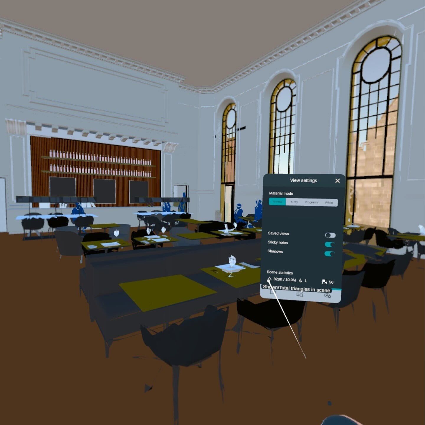

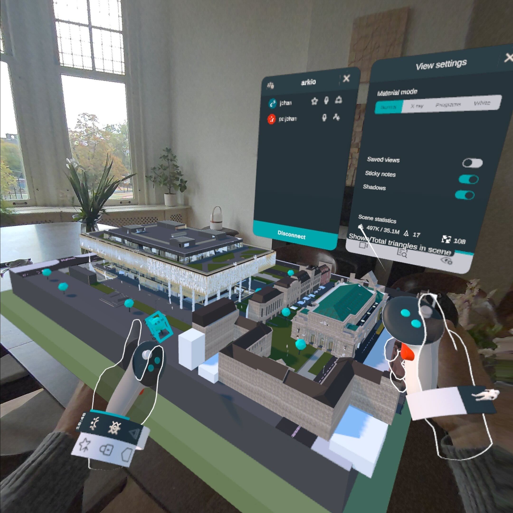

828K/10.9M on Quest 3 standalone
5.4M/10.9M on Quest 3 in PC link mode

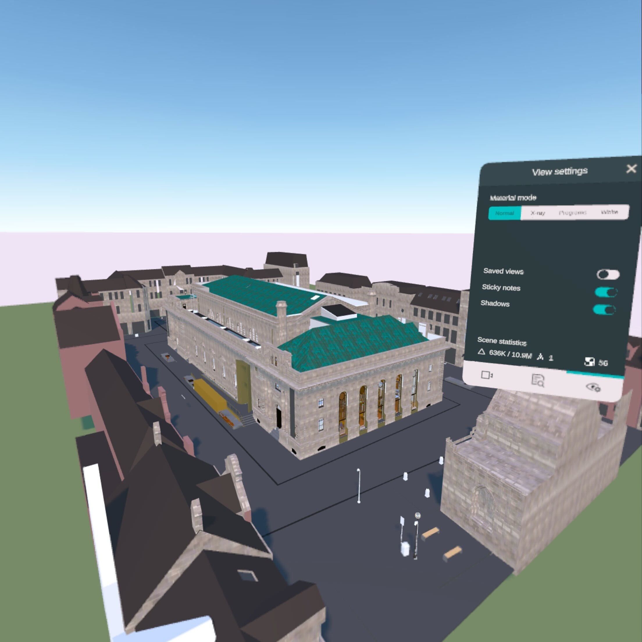

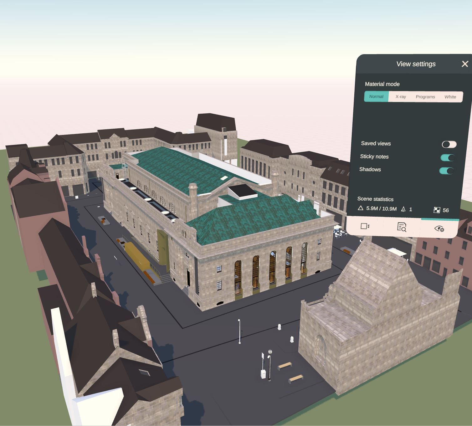

636K/10.9M on Quest 3 standalone
5.9M/10.9M on Quest 3 in PC link mode

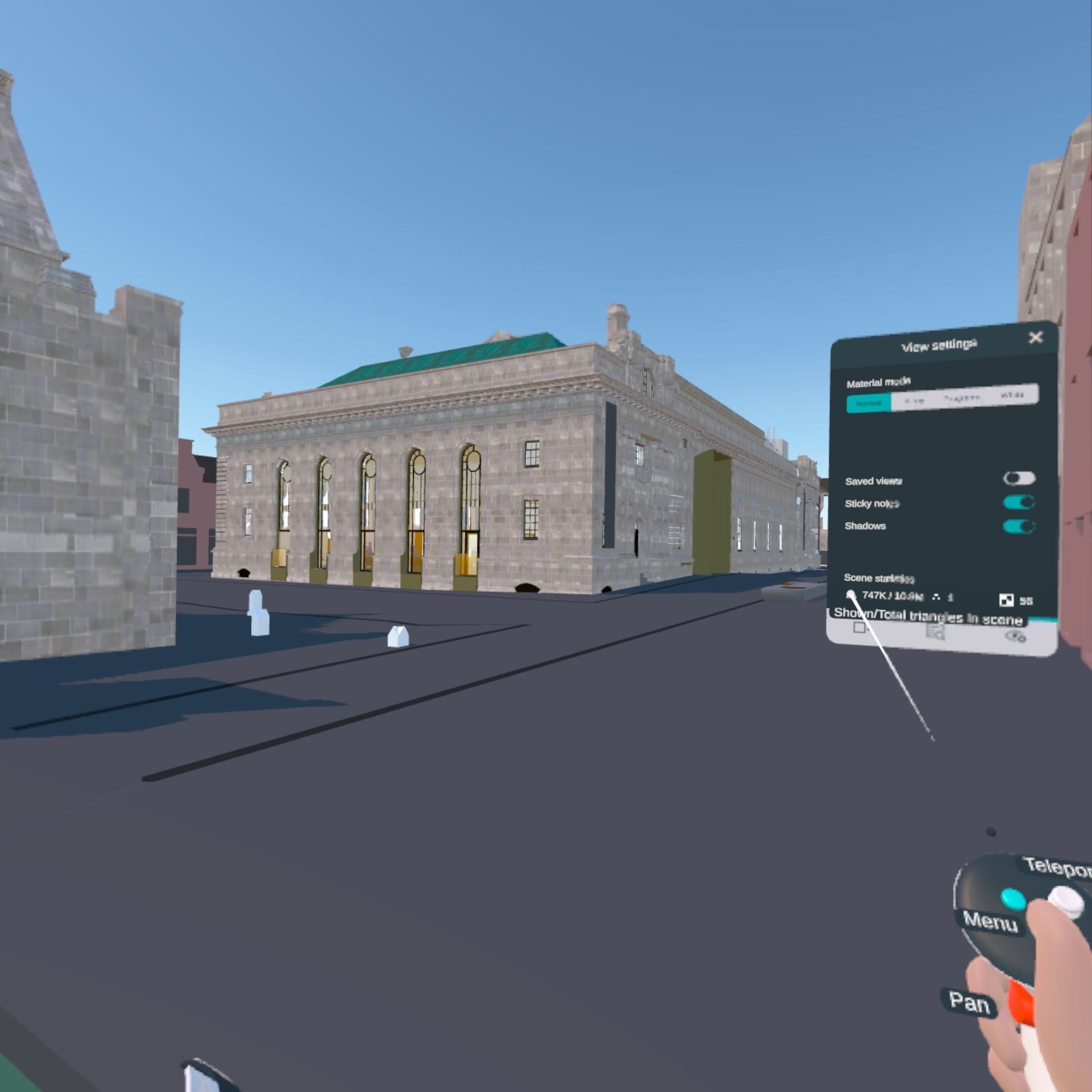

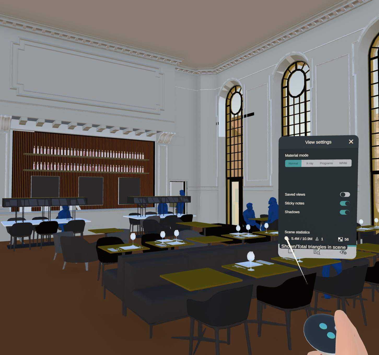

747K/10.9M on Quest 3 standalone
5.0M/10.9M on Quest 3 in PC link mode

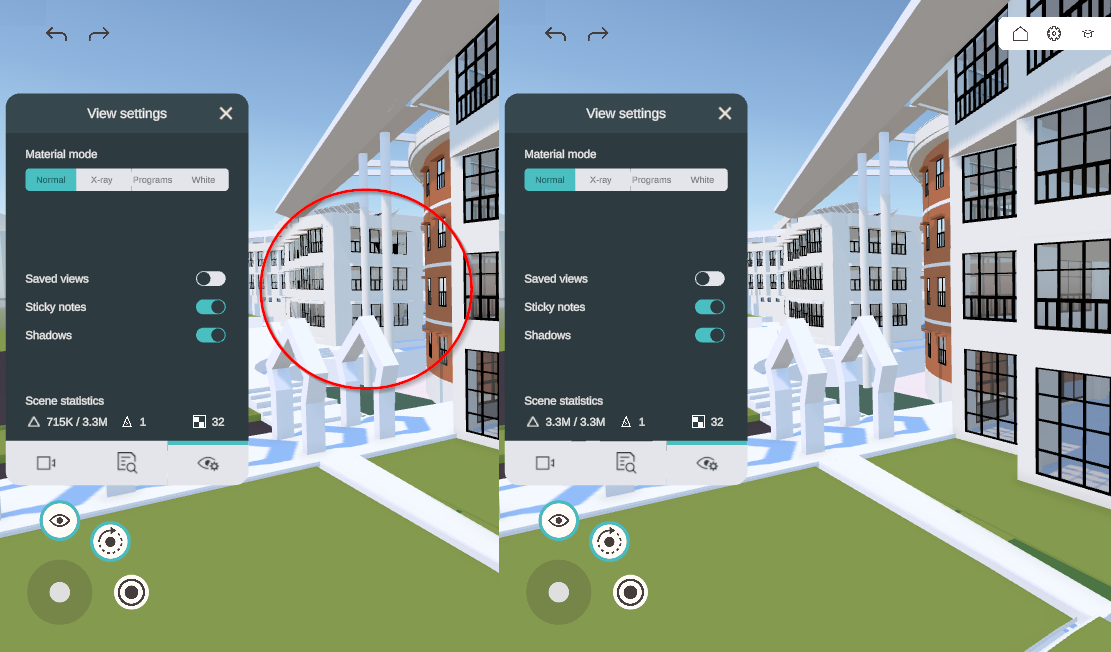

Arkio simplifies geometry based on your viewing distance using dynamic occlusion, reducing detail on parts of the model that are occluded by other geometry. This way, details closer to the user can be maintained, while objects that are obstructed have reduced detail.
When working with devices with limited performance and models with dense triangles, this can result in artifacts. Especially when your model has complex overlaps, parts of it can appear less detailed from certain viewpoints.
To prevent these low-detail areas from showing, you can reduce the triangle geometry in your exports, freeing up more render budget for the important details in your design. The easiest way to do this is to use Arkio’s Revit and Rhino plugins and select a lower level of detail during export. This page contains additional tips for optimizing your model for less powerful devices.
